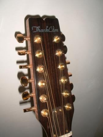

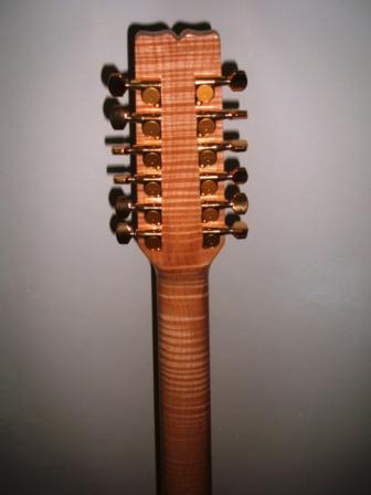

Here's a couple of pictures of my headstock with tuners and 1" spacing. The headstock is rather long but the balance is okay.
I probably would have had the first tuners placed closer to the nut and shortened the top a bit if I did it again. The taper helps keep the headstock lighter.
The tuners are Gotoh and I think they are just a few thousands of an inch longer than the Schallers. You can see that there is not much space between tuners with the screw holes. If you get much closer they will be touching.
Stewart MacDonald has diagram sizes in their catalog but they don't show the button size. I don't know if the Schaller buttons are the same size. If you use a cheap plastic speedwinder designed for regular size buttons, you will bump other buttons if they are in line. If you stop at 90 degrees and fine tune by hand, you will not have a problem

Cecil, the pics you showed are pretty much how my design looks at the present time. I think I'll just go ahead with the 1" spacing, it looks good to me. I'll let the owner worry about changing the strings.

    Cecil, Nice work on the twelve. THe headstock is tastefully done.
    I saw your headstock logo before and tried to read it, to no avail. Now I see your in Viet Nam!
    Is there a big market over there for acoustics. It's great talking to people from all over the world! Again, nice work!
